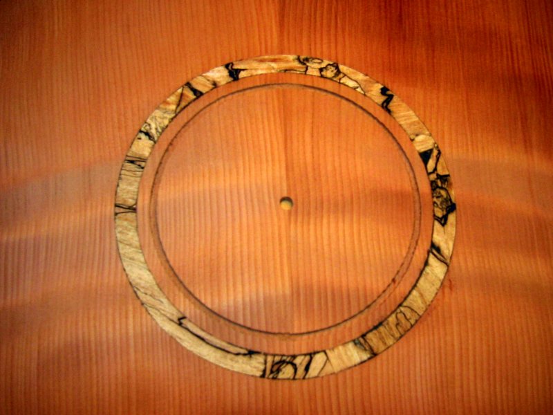

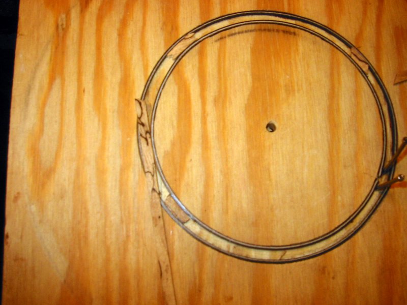

I fell in love with a spalted maple rosette I saw on a guitar some time ago. Trying to figure out how to do this.
Working on a piece of plywood, I routed the channel and lined it with BWB purfling for starters. Now I am not sure how to cut the strips of maple to insert.
One approach I tried seemed to work as follows: Spalted Maple is fragile as you probably know so I simply forced it into the channel like you do with Abalam. Seemed to work ok and I was thinking I might shellac and then wipe some black dye which would accent the breaking points giving it a marbelized look which is common to Spalted.
The only other approach I was considering is cutting pieces into small bites and fitting them by sanding slight contour on inside and outside edges but that seems like an awfull amount of work and patience.
Here is a picture to help better understand

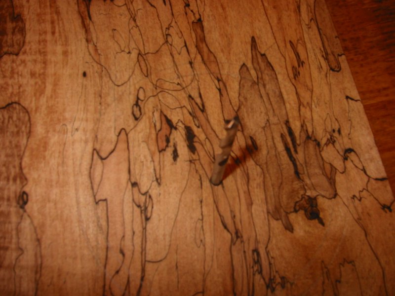

Here's a spalted Ambrosia maple ring from our very own BobC:

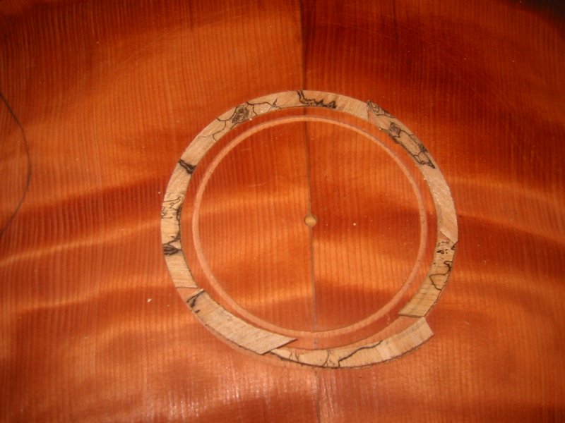

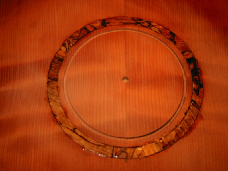

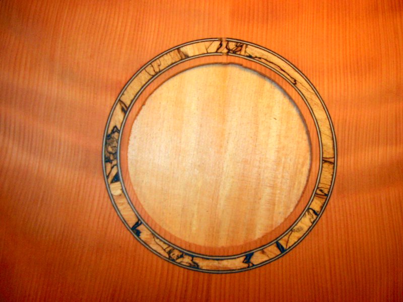

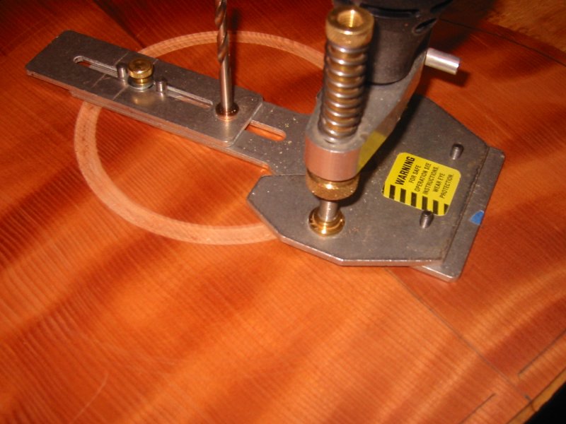

Ok, with your help here is how I approached and the end result:
First, routed channel in the soundboard. Then used this a guide to cut the ring from the spalted maple board I had. Actually, made several partial cuts with the dremel and ste mac circle cutter to capture as much figure as I could. Required a little joining but the black ink lines hide this well.
Then glued the rosette in and then as you suggested here, routed the purfling line channels and presto - pretty nice!!
One additional point. Once I had the maple installed and prior to routing the rosette channel I wicked cyano into the maple to stabilize it and prevent chip out on the edges. Kept applying the cyano until it no longer sunk into the maple which was quite a bit and worked carefully around the edges hoping it wouldn't wick into the soundboard which was shellaced prior to rosetting. Worked great.

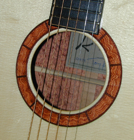

I usually do my all wood rosettes as mentioned above - make the ring first, inlay it, then cut a small channel for the purf rings or shell whichever is going in. Another cool way to do this, and get the most spalt liens in is to make a segmented rosette using identical pieces, my jig is set up to make 10 piece rosettes from a 1 inch wide piece of stock - if you flip the piece every time you make a cut, the pieces make the grain lines go around the rosette (as in the pic - this is quilted bubinga cut on the quarter face, revealing wave figure). I like to accent the joints with a colour line(s). Or if you have the ability to bookmatch two one inch strips from a chunk, you can cut matching pieces from each one and then arrange them in a bookmatched pattern around the rosette.All that said, if its possible to get a lot of spalted figure in a one piece ring, I would likely do that instead.

[QUOTE=TonyKarol] I usually do my all wood rosettes as mentioned above - make the ring first, inlay it, then cut a small channel for the purf rings or shell whichever is going in. Another cool way to do this, and get the most spalt liens in is to make a segmented rosette using identical pieces, my jig is set up to make 10 piece rosettes from a 1 inch wide piece of stock - if you flip the piece every time you make a cut, the pieces make the grain lines go around the rosette (as in the pic - this is quilted bubinga cut on the quarter face, revealing wave figure). I like to accent the joints with a colour line(s). Or if you have the ability to bookmatch two one inch strips from a chunk, you can cut matching pieces from each one and then arrange them in a bookmatched pattern around the rosette.All that said, if its possible to get a lot of spalted figure in a one piece ring, I would likely do that instead.
Tony, I am thick when it comes to this stuff. Do you know of any web sites that show this process step by step with pics? Or would you consider adding a few pics for examples?
PostPosted: Sun May 14, 2006 10:26 pm
Not off hand Rich - maybe later today or sometime I can take some shots of the jig which is the most critical part to do this - mine cuts fairly accurate - you need to be under 1/10 degree or the segments wont be that close to closing when you put it all together - I thought about it one day and here is why - a 10 segment rosette has 20 cuts, two on each piece. So if your cuts are off by 1/10 degree, on 20 cuts thats 2 degrees in total - over a 4.5 inch rosette, that means that the gap is about 1/8 inch.

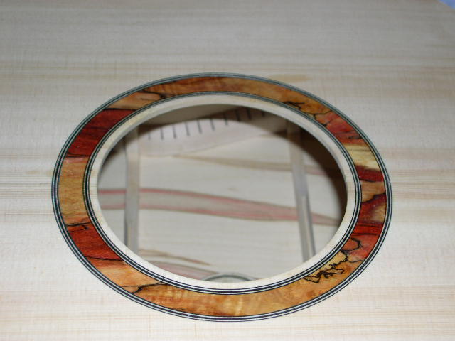

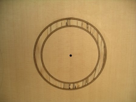

I just finished a spalted maple rosette last weekend. I use the same technique as Lance: route a channel in the top, cut a ring of the maple and inlay. After the glue dries, I cut the purfling channels. Here it is:
I got the rosette square and the purfling from BobC at RC Tonewoods.
